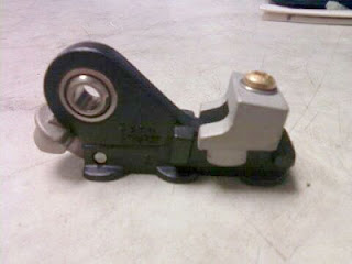

<a href="http://3.bp.blogspot.com/-knnCsW9gNZY/UKZ4emyP6-I/AAAAAAAAEQo/GNQqot8WNqA/s1600/imagejpeg_2+(1).jpg" imageanchor="1" style="clear: left; margin-right: auto; margin-bottom: 1em; margin-left: auto;">
American's pesky saddle clamp

  • Two of the airline's 757s which have seat re-pitching performed by Timco have seats come dislodged during flight.
  • A re inspection of forty eight 757s turns up more than a dozen airplanes with incorrect seat installation.
And all these events follow the decision by American to take seat installation work from its own unionized and licensed mechanic work force and subcontract it to non unionized and only partially licensed contract maintenance workers, where at least one company is using students who are enrolled at National Aviation Academy, a school for aviation mechanics with a branch in Bedford, Massachusetts.
One would have to be extremely naive to believe these things are unrelated.

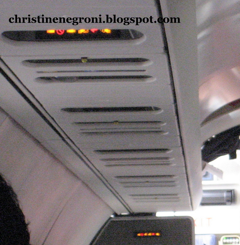

Several people who have seen the troublesome 757s say these modifications were poorly performed. Holes were punched in the sidewall of the arm rest to run the wires and the protective grommet which is designed to keep the wire insulation from being damaged by the rough plastic was not installed.
"The wires were pulled and crimped where the wire meets the plastic," I was told by an experienced mechanic who viewed the airplane the day after its arrival in Boston and who did not want to be identified.
Overhead, the PSU covers also showed signs they had been removed carelessly. "Removing the overhead panels takes a special technique," my mechanic friend said. "These passenger service units, they can frustrate the hell out of you," it takes some finesse to loosen them correctly, he said.

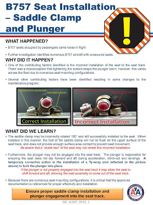

Two weeks later American's engineering department produced a full color, illustrated advisory for workers.
DON'T assume tightening screws will secure the seats if the clamp is not properly installed, is one tip. DO refer to the documentation for proper installation is another. To these, I'd add one more.
When your workers are unfamiliar with the assignment or the parts, inexperienced, unlicensed or currently matriculating in mechanic school DO follow common sense and federal regulation and check that their work is performed correctly.
