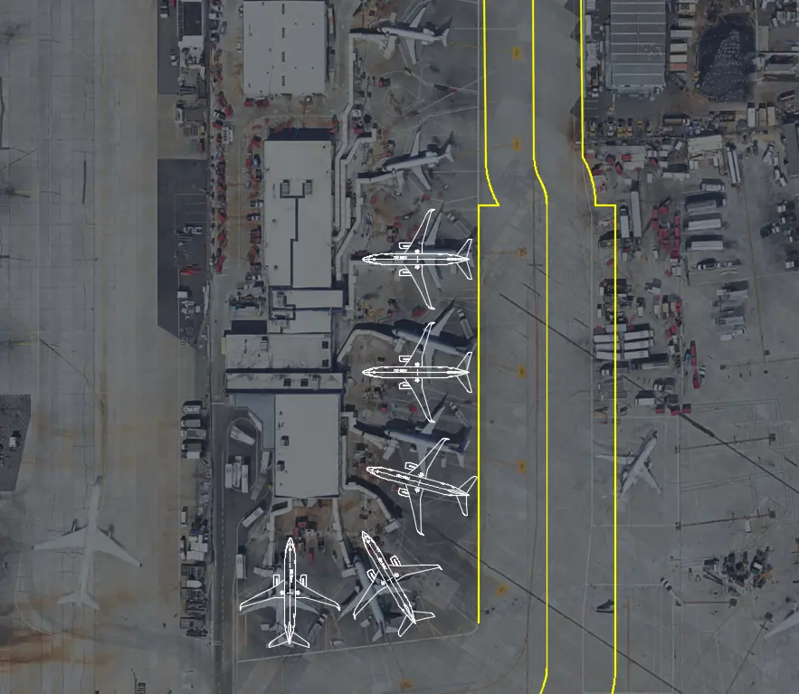

Just curious, and I don't pretend to know LAX all that well... I assume "the Eagle's Nest" would Express flying, so but how difficult would it be to convert those gates into mainline flights? Re-configure the gates and move jet bridges maybe? Are the gates deep enough to handle a B738 or even an A321?
I'll preface this by saying I'm not intimately familiar with LAX either, and I just threw this together in about 10 minutes:
If all that equipment on the east side of the existing taxilane can be squeezed farther east, and AA can part with those two hardstands, then you theoretically could convert part of that to an ADG-III taxilane. I'm not sure if you could achieve a proper slope for jetways as the facility is at ground level though, and there appears to be quite a bit of utility hardware that protrudes from the apron closer to the building. Then there's the issue of the processing capacity of the building, other operational issues that I'm probably not aware of, and isn't there some kind of gate cap at LAX or has that been recently amended?

That was a nice job... I would have taken me a week to put that together. My continued working hypothesis is that LAX will continue to expand its O&D offerings, while Express flying will transfer to PHX, which is why I asked my original question.
I assume if your diagram is accurate (with the Devil in the details), then more mainline flying could be moved into the Eagle's Nest after some major modifications to the ramp and jet bridges. Maybe keeping some of the Express flying from very close locations such as SAN, PSP, BFL, etc. with gates otherwise inaccessable to mainline aircraft instead of routing through PHX to get to LAX?
