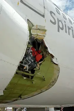

Images of the Boeing 747-400 after it landed showed a large hole where the leading edge of the wing attaches to the fuselage.

Here's my question: from the photo, it looks like luggage and clothing up against the hole.
I thought most all luggage loaded onto jumbo jets was loaded into LD4s (or LD3s). Wasn't that a result of PanAm 103?
Luggage has to be in a container except in the bulk cargo area aft of the aft cargo bay. The floor is wide open with minimal floor panels just to walk on. They make expensive bomb proof Kevlar containers but only EL AL uses them. There was some talk about making then mandatory but they'll only do that if there is another mass killing. Normally airlines carry a spare tire in the bulk cargo area but they may have had one in a maintenance container or even a large crew oxygen bottle. There could have been scuba tanks on board also. All this is pure speculation. Whats really scary is aircraft maintenance in third world countries because of the lack of background over site. A radical mechanic could place hidden bombs behind cargo bay wall panels that would go off at the same time. Could you imagine 50 airplanes blowing up at the same time? This has been discussed in the US but there are no ears in Washington.

A source close to the Civil Aviation Safety Authority (CASA) in Australia said: “It is looking extremely likely that one or more of the oxygen tanks exploded. It’s never happened before so nobody knows what caused it. It could be as simple as some cargo shifting and smashing into it, which shouldn’t be able to happen.â€￾
The investigators added, however, that it is too early to discount metal fatigue, whereby the fuselage is weakened over time by the expansion and contraction of the plane during take-off and landing. This creates tiny cracks in the fuselage which are invisible to the eye, but which can eventually give way.
As well as the debris, investigators also found that the floor above the tanks had been pushed upwards, which is more consistent with an explosion.
The CASA source said: “In a normal depressurisation, if a fuselage had metal fatigue and a hole was suddenly ripped in it, everything would be sucked down and out. But in fact the floor above the bottles has been blown upwards, which is more consistent with an explosion.â€￾

MANILA, Philippines (AP) -- Investigators found fragments that appeared to bolster the theory that an oxygen tank exploded on board a Qantas jet, forcing it to make an emergency landing with a car-sized hole in its fuselage, an official said Monday.
Qantas pilot Captain John Francis Bartels looks at the damaged fuselage in Manila, Philippines.
A valve and other small fragments that were found would be tested to determine if they came from the tank, which is designed to provide oxygen to passengers during an emergency, said Neville Blyth, a senior investigator from the Australian Transport and Safety Bureau.
"We recovered ... a valve from an oxygen cylinder," Blyth said. "It is likely that that valve is from the missing cylinder."
The fragments were found close to where the missing tank was stored beneath the passenger cabin, he said.
If the valve and other small fragments are determined to have come from the cylinder, further investigation would be required to determine why the tank burst, he said.
